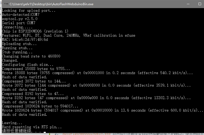

- Double click autoflashwebduinobin.exe to run the script will automatically select the latest access to the serial port, burning the corresponding firmware file with the directory below, a total of four files are as follows:
bootloader_dio_40m.bin partitions.bin boot_app0.bin webduino.bin
The burn end script restarts the board automatically. Completion of burning:
