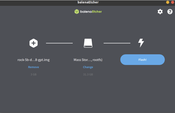

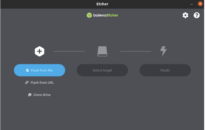

  • In the etcher window, click Select image.

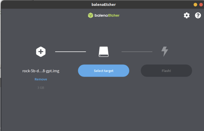

  • In the etcher window, click Select Drive.
  • In the etcher window, click Flash.

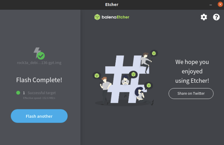

  • In the etcher window, once it shows us Flash Complete! It is done and can be put into the RockPi.
