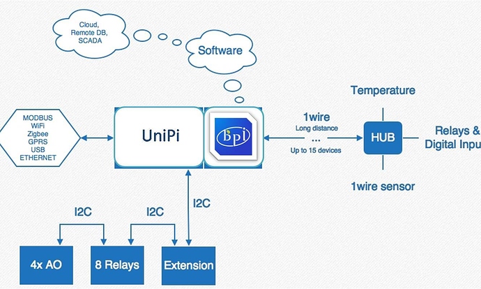

Overview
UniPi board is designed to fit the cheap and easy to use Raspberry Pi mini computer. It has 8 changeover relays, 14 digital inputs, single channel 1wire interface, 2 analog inputs 0-10V and one analog 0-10V output. Furthermore the second I2C port of the RPi features 5V level converter and ESD protection, so you can easily connect other devices. The same applies to the UART!
Does it have anything else that might be usable? Of course! It has Real Time Clock module so if your Pi looses power, the clock stays synced so when the system comes up, it will do everything as planned.
