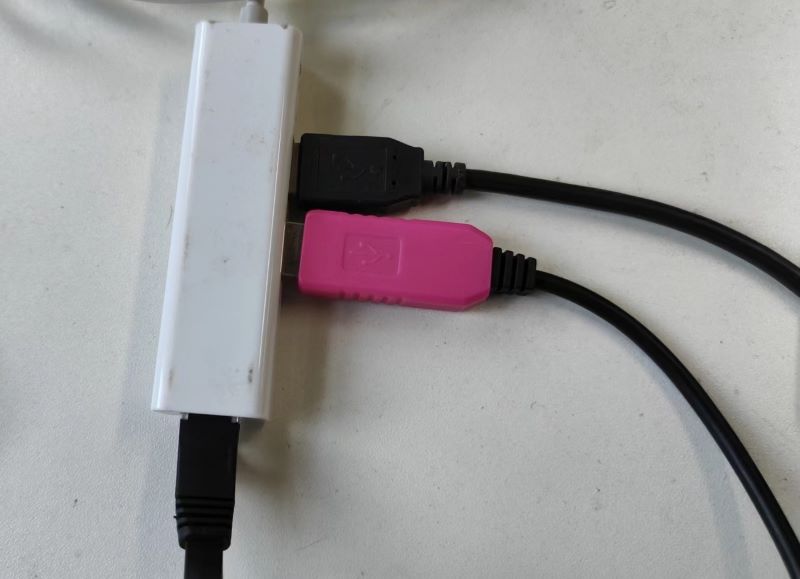

2. Connect one end of the TTL cable to the computer
Insert the development board at the other end. (RX and TX need to be connected in reverse, VCC does not need to be connected)
