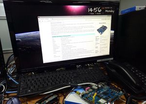

After succeed to burn u-boot on W2, then install OpenWRT on W2.
1)You need these tools and files:
  • U disk
  • install.img
2)Burn OpenWRT on W2 steps:
  • Format U disk as FAT32 filesystem
  • Copy install.img to U disk root directory
  • Decompress install.img to get four files:
  emmc.uImage
  rescue.root.emmc.cpio.gz_pad.img
  bluecore.audio
  rescue.emmc.dtb
  • Plug U disk to W2 USB3.0 interface,holding press “Esc” button to power on W2 board
  • Then W2 board will go into u-boot console
  • Input these commands step by step:
  setenv bootargs "earlycon=uart8250,mmio32,0x98007800 console=ttyS0,115200 loglevel=7
  init=/etc/init root=/dev/mmcblk0p1 rootfstype=squashfs rootwait"
  save
  go ru
  • Waiting for OpenWRT burning,after finished,W2 will reboot and go into OpenWRT system.
