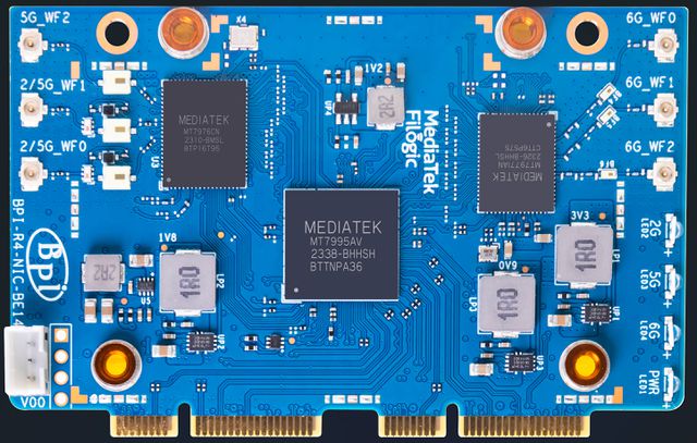

4.1)BPI-R4-NIC-BE14
BPI-R4-NIC-BE14 Block_Diagram: MT7995AV+MT7976CN+MT7977IAN
root@OpenWrt:/# lspci
0000:00:00.0 PCI bridge: MEDIATEK Corp. Device 7988 (rev 01)
0000:01:00.0 Network controller: MEDIATEK Corp. Device 7990
0001:00:00.0 PCI bridge: MEDIATEK Corp. Device 7988 (rev 01)
0001:01:00.0 Network controller: MEDIATEK Corp. Device 7991
0004:00:00.0 Unclassified device [0002]: MEDIATEK Corp. Device 7981
