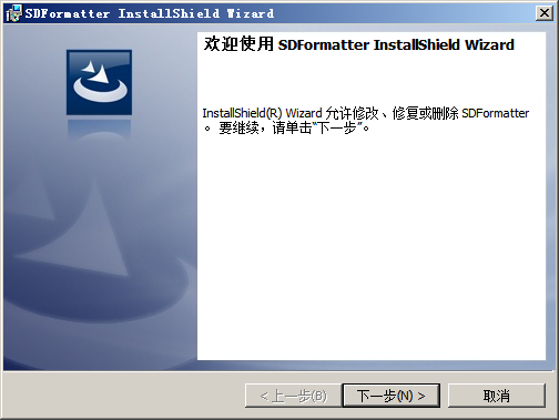

Open SDFormatterv4, double-click “Setup”, like the follow picture: 打开文件夹SDFormatterv4,双击setup,如下图所示
“next step” , go in Installation directory and choose” Default installation”,
“next step” , choose installation again
“finish”
首先选择“下一步”,进入安装目录选择(默认安装目录),然后在选择“下一步 ”,再次选择“安装”等待安装结束,最后选择“完成”自动退出安装窗口,SDFormatterv4安装完成。

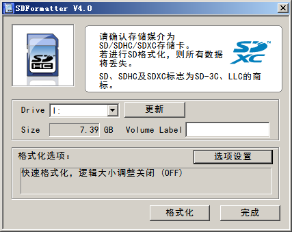

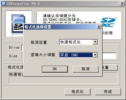

Choose” Drive (according to PC display)
Choose “Option settings”, and set the “adjust Logical size” to “ON”,like the follow picture:
首先选择Drive(根据PC实际为准),然后选择“选项设置”将逻辑大小调整选择,“开启(ON)”如下图所示
Choose”OK”
Then Format
Finish
接下来选择“OK”选择“格式化”,选择“确定”,选择“确定”,选择“确定”,选择“完成”,自动退出窗口,格式化完成。

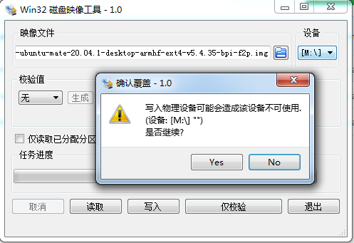

Install the SD which has formatted in card reader, and install the card reader in PC
Open Win32DiskImager, choose device and image file, then burn in. Then choose “OK” (cover), like the follow picture:

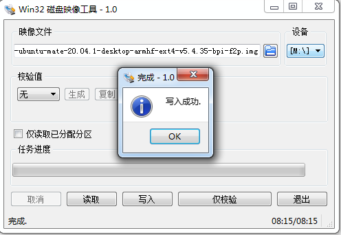

After finish, the page will show “ OK”
首先将格式化好的SD卡,插入读卡器,读卡器插入电脑PC端USB接口,打开Win32DiskImager烧录工具,选择设备(根据PC端实际为准),选择镜像文件,选择写入,选择YES(覆盖),烧录完成出现写入OK,弹出SD卡,如下图所示

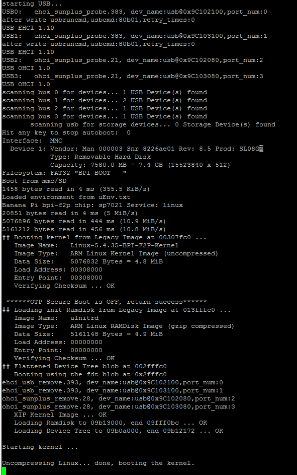

After finish burning, install the SD card in F2p Board, then it can boot 烧录完成,将SD卡插入F2p开发板启动。

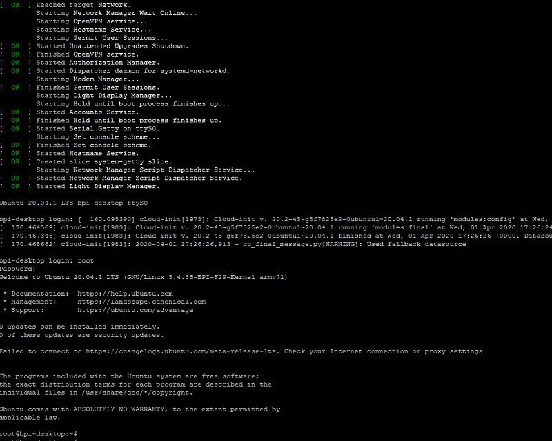

Serial Console Output: 调试串口输出:

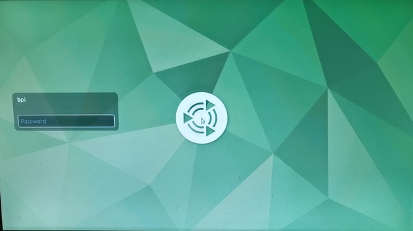

HDMI Interface Display:
HDMI接口显示:

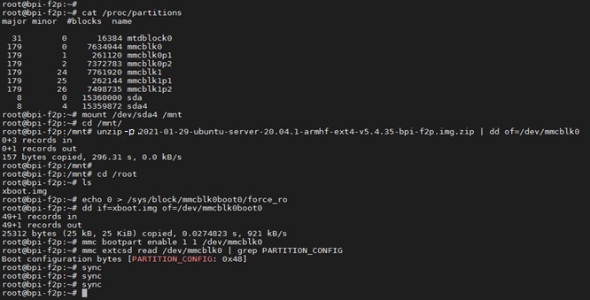

3.Mount USB flash disk to /mnt挂载U盘到 /mnt
Input instruction输入指令:mount -t vfat /dev/sda1 /mnt
Input instructionto USB flash disk输入指令进入U盘:cd /mnt
4.Burning the image to EMMC烧录镜像到EMMC
Input the below instructions, like the follow picture 输入如下1条指令如下图:
unzip –p 2021-01-29-ubuntu-mate-20.04.1-desktop-armhf-ext4-v5.4.35-bpi-f2p.img.zip | dd of=/dev/mmcblk0
echo 0 > /sys/block/mmcblk0boot0/force_ro
cd /root/
dd if=xboot.img of=/dev/mmcblk0boot0
mmc bootpart enable 1 1 /dev/mmcblk0
mmc extcsd read /dev/mmcblk0 | grep PARTITION_CONFIG
sync
sync
