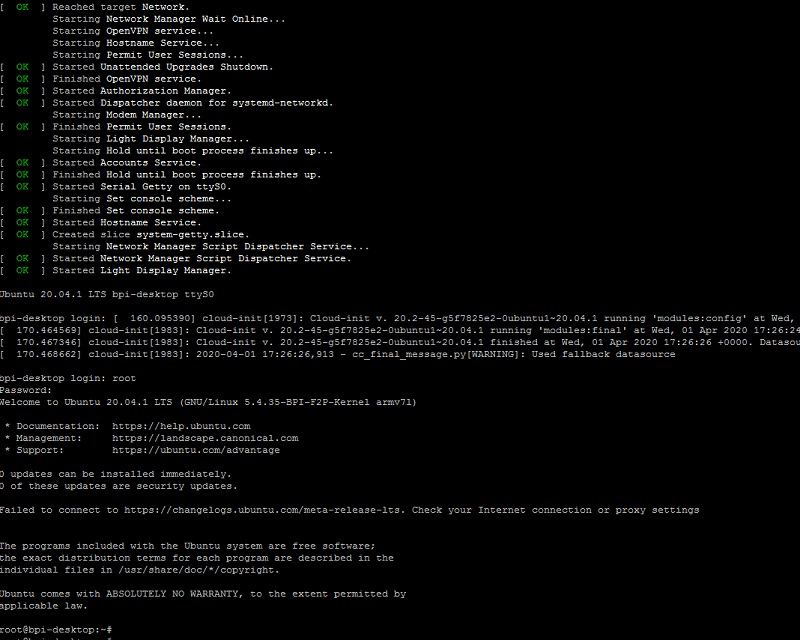

After finish burning, install the SD card in F2p Board, then it can boot 烧录完成,将SD卡插入F2p开发板启动。 Serial Console Output: 调试串口输出:

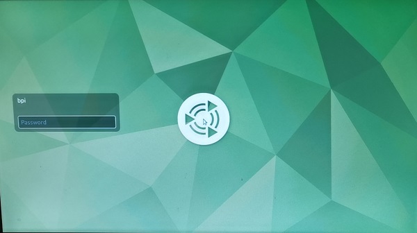

HDMI Interface Display: HDMI接口显示:

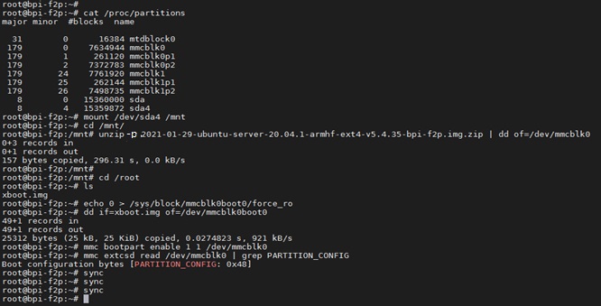

How to boot form EMMC, EMMC启动步骤
1.Burning image烧录镜像 Firstly Burning 20201-01-29-ubuntu-mate-20.04.1-desktop-armhf-ext4-v5.4.35-bpi-f2p.img in SD card and boot up. Refer to the below picture: Console Serial, Username: root, Password: bananapi 先将2021-01-29-ubuntu-mate-20.04.1-desktop-armhf-ext4-v5.4.35-bpi-f2p.img 烧录到SD卡启动。如下图: 调试串口, 用户名:root, 密码:bananapi
2.Copy the same image compress file you want in USB flash disk volume root directory, and plugin the USB flash disk in b2p board’s USB port. 拷贝需要的烧录镜像压缩文件到U盘根目录,插入B2p开发板USB座。
  2021-01-29-ubuntu-mate-20.04.1-desktop-armhf-ext4-v5.4.35-bpi-f2p.img.zip
3.Mount USB flash disk to /mnt挂载U盘到 /mnt Input instruction输入指令:mount -t vfat /dev/sda1 /mnt Input instructionto USB flash disk输入指令进入U盘:cd /mnt 4.Burning the image to EMMC烧录镜像到EMMC
 Input the below instructions, like the follow picture 输入如下1条指令如下图:
unzip –p 2021-01-29-ubuntu-mate-20.04.1-desktop-armhf-ext4-v5.4.35-bpi-f2p.img.zip | dd of=/dev/mmcblk0 echo 0 > /sys/block/mmcblk0boot0/force_ro cd /root/ dd if=xboot.img of=/dev/mmcblk0boot0 mmc bootpart enable 1 1 /dev/mmcblk0 mmc extcsd read /dev/mmcblk0 | grep PARTITION_CONFIG sync sync
5.Finish the burning, remove SD card and USB flash disk, Push the Red Switch PIN to off, re-power on and boot from EMMC 烧录完成,取出SD卡及U盘,将红色的拨码开关设成off, 重新上电EMMC启动。
