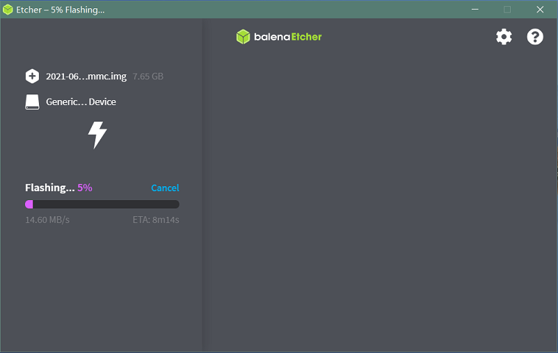

Install Image to SDcard
1. Install Image with Balena Etcher on Windows, Linux and MacOS.
Balena Etcher is an opensource GUI flash tool by Balena, Flash OS images to SDcard or USB drive.

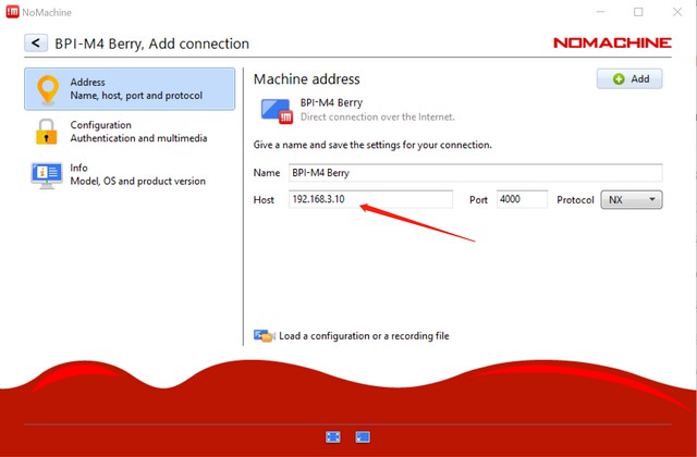

NoMachine Remote Desktop
1. Make sure BPI-M4 Berry is connected to the Internet and use the following command to download the nomachine DEB installation package in the system.
  wget https://download.nomachine.com/download/8.9/Arm/nomachine_8.9.1_1_arm64.deb
2. Or open NoMachine for ARM - arm64 download page in a PC browser, download the DEB installation package, and then copy it to BPI-M4 Berry user directory through SSH or USB disk.
3. After the download is completed, install it through the following command. Note that the file name is based on the actual downloaded file name.
  sudo dpkg -i nomachine_8.9.1_1_arm64.deb
4. PC side also needs to download and install NoMachine. NoMachine download page Select the installation package suitable for the PC operating system, download it locally and complete the installation.
5. Pay attention to keeping the PC and BPI-M4 Berry in the same LAN. You can try SSH connection first to ensure normal communication within the LAN.
6. Open NoMachine on the PC, click the Add button, enter the IP address of BPI-M4 Berry in the Host bar in the window after the jump, and then click the Add button.
7. Click the recognized port icon, enter the username/password in the new window that pops up, and then click the OK button.
8. After completing the subsequent settings, you can see the desktop.
9. If no device is connected to the HDMI interface, the NoMachine remote desktop will display a black screen. It is recommended to keep the HDMI connection or connect an HDMI decoy device.

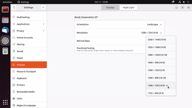

Modify HDMI output resolution
When using the Ubuntu desktop operating system, you can find the Displays column in Settings and modify the resolution.

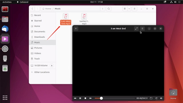

Use Audio Devices
Prepare an audio file and copy it to the BPI-M4 Berry Ubuntu desktop system through a USB flash drive or SSH.

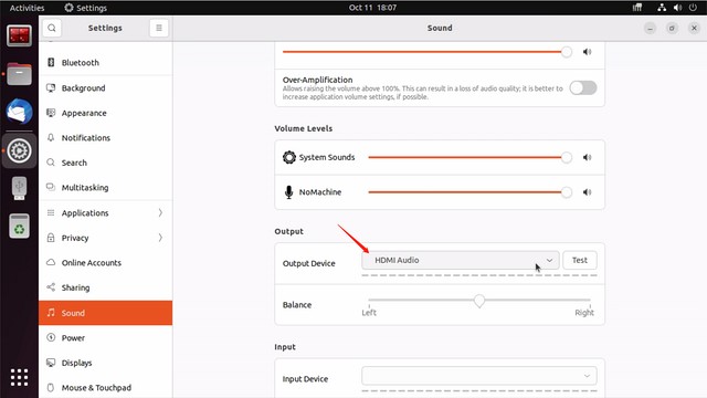

HDMI audio
1. Prepare a monitor with HDMI audio input function, turn on the relevant functions in the monitor settings, and use an HDMI cable to connect the monitor.
2. Set the output device to HDMI Audio in the Sound column of the settings.
3.Play audio.

2. Set the output device to Audio Codec in the Sound column of the settings.
3. Play audio.
Terminal command to play audio files

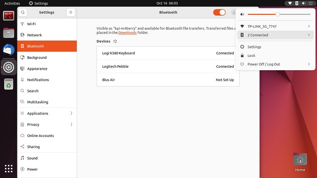

Use Bluetooth
1. Open settings in the Ubuntu desktop and connect a Bluetooth device, such as a Bluetooth mouse or keyboard, in the Bluetooth bar.
2. The method to connect the Bluetooth device through the command line in the terminal is as follows:
