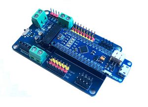

This robot board is design for Arduino Nano and Nano compatible boards. It is designed by Harsh Dethe and made by BPI factory.
BPI-Nano robot board's motor drive expansion plate available in the bpi-nano controller supports dual-circuit motor control, with single maximum current up to 1A.
Arduino standard pin design interface, also can be used with Arduino Nano. It can be use for the development of small mobile robots.
Technical specifications
  • Driver chip: L293B
  • Logical working voltage: 5V DC
  • Motor drive voltage: 7-12v DC
  • Maximum driving current: 1A (per circuit)
  • Pin for motor drive: pin4/5/6/7 (Arduino controller)
  • Size: 75mmx45mm
Hardware interface
PIN define
BPI-Nano aruino Nano robort GPIO pin define
Pin Function
Digital 2、4 Motor2 Steering control, 2 high level, 4 low level positive turn;Whereas inversion
Digital 3 Motor 2 Enable interface, high level enable
Digital 5 Motor 1 Enable interface, high level enable
Digital 7、8 Motor 1 Steering control, 7 high level, 8 low level positive turn;Whereas inversion
