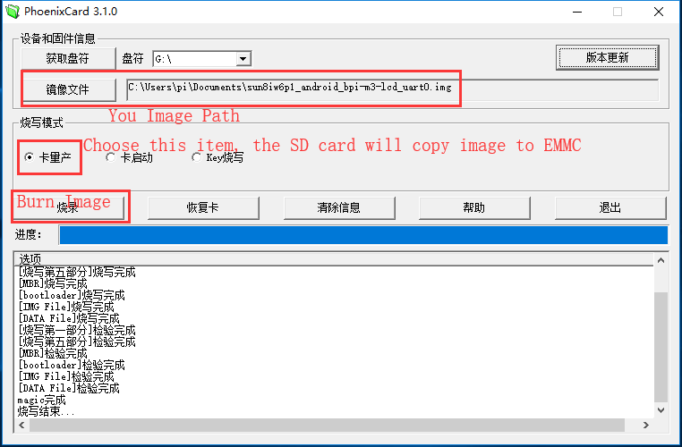

===Load your image on M2P EMMC=== | |||
1.The only different with sd card burning is the image burning mode item choice | |||
* Here is the example of M3 | |||
[[Image:M3_Android_Emmc_Burning.png]] | |||
2.After succeed to burn image to SD, then plug SD card in your M2P | |||
3.Press power button, device will copy image to EMMC automatically | |||
* Download PhoenixCard: https://pan.baidu.com/s/1-fjvPqtG_zewVzqnXf1AHw?pwd=eid9
