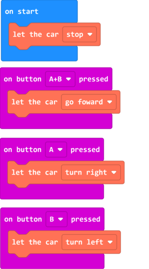

=Use MakeCode to Control the Triode-Car=
Line 57: Line 85:
# Press B to turn Left.
Example link:https://github.com/Wind-stormger/Makecode/blob/master/microbit-Triode-car_motor_control_1.hex
[https://github.com/Wind-stormger/Makecode/blob/master/microbit-Triode-car_motor_control_1.hex '''Example link on Github''']
Project files can be downloaded and edit locally by importing to MakeCode, or flash it directly onto the Micro:bit via USB to run it directly.

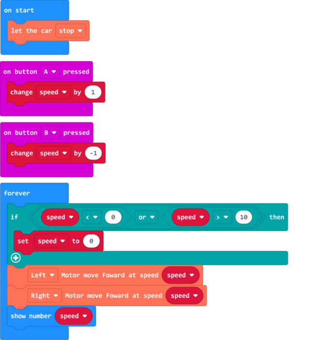

===调整电机转速===
===Motor Speed Adjustment===
Triode-Car专用扩展积木中有可单独控制左右电机转速的积木,可进行10级调速。
In the Triode-Car extensions, there are blocks dedicated to adjust the speed up to 10 levels.
例程如下图所示,按一次A按钮转速加1档,按一次B按钮转速减1档,Micro:Bit显示当前挡位数值。
'''Example Blocks:'''
[[File:Triode-Car_motor_control_2.png|640px]]
其中"forever"积木会在"on start"积木执行完后开始无限循环执行其内部的积木,而在每次循环的间隙则可执行其他事件处理程序,如on button A/B pressed。
# When button A is pressed, the speed increases by 1 level
# Press button B once, the speed decreases by 1 level
# Micro: bit display current speed.
加入了一个"if"判断积木,若变量"speed"值小于0或大于10时,将变量"speed"值设为0,这样可以将值限定在0到10范围内不会溢出而报错。
The code within "forever" block will loop forever after the code in "on start" finishes. In between each loop, it can perform other actions such as, on button A/B pressed.
例程项目文件:https://github.com/Wind-stormger/Makecode/blob/master/microbit-Triode-car_motor_control_2.hex
Added an "if" statement block to make sure the "speed" variable does not go higher than 10, if it goes higher, it will be set to 0 to prevent error messages.
项目文件下载到本地后可导入MakeCode中查看和再编辑,也可直接通过USB烧录到Micro:Bit中直接运行。
[https://github.com/Wind-stormger/Makecode/blob/master/microbit-Triode-car_motor_control_2.hex '''Example link on Github''']

  1. As the blocks shown, the car will stop after bootup or reset.
  2. Pressing down button A and B at the same time will make the car go forward.
  3. Press A to turn Right.
  4. Press B to turn Left.
Example Blocks:
  1. When button A is pressed, the speed increases by 1 level
  2. Press button B once, the speed decreases by 1 level
  3. Micro: bit display current speed.
