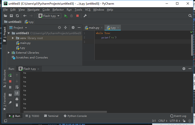

- Select the configured device, and then click the green triangle to run. The red square indicates that it has stopped running. If it fails, just retry
- The results

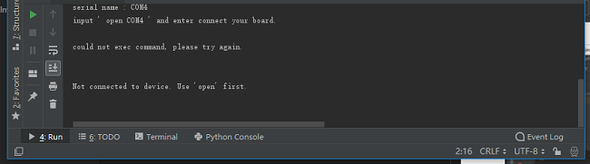

- The common failures are shown below, just like the mpfshell, because the underlying layer is the same.
