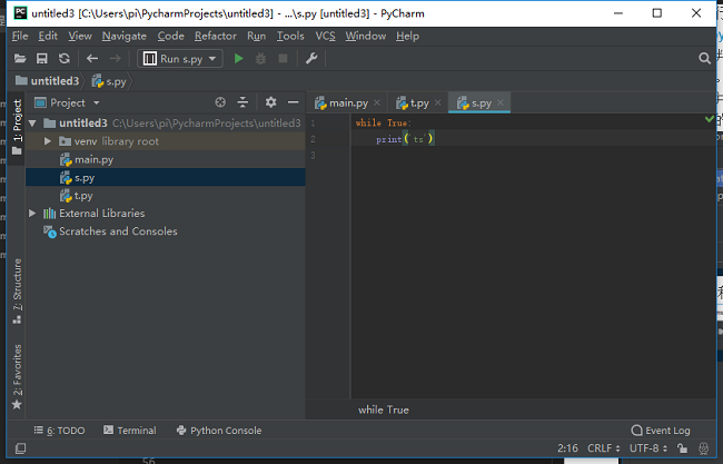

  • Prepare a project and add a file as shown.

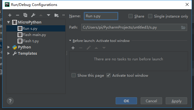

  • First configure the current file, as shown in the figure
  • Just set the Name and Path
