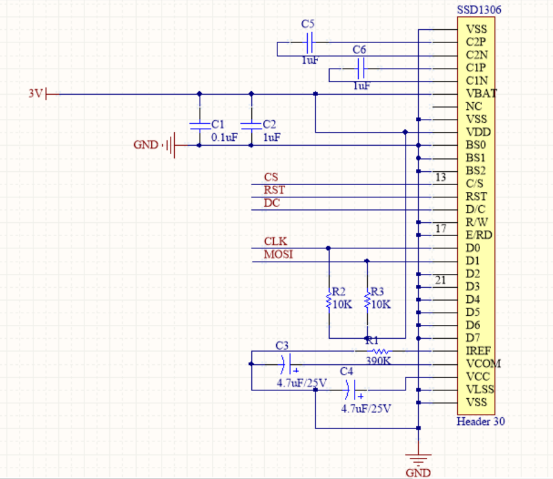

==Schematic diagram== | ==Schematic diagram== | ||
| − | + | [[File:Oled_4.png]] | |

Schematic diagram
