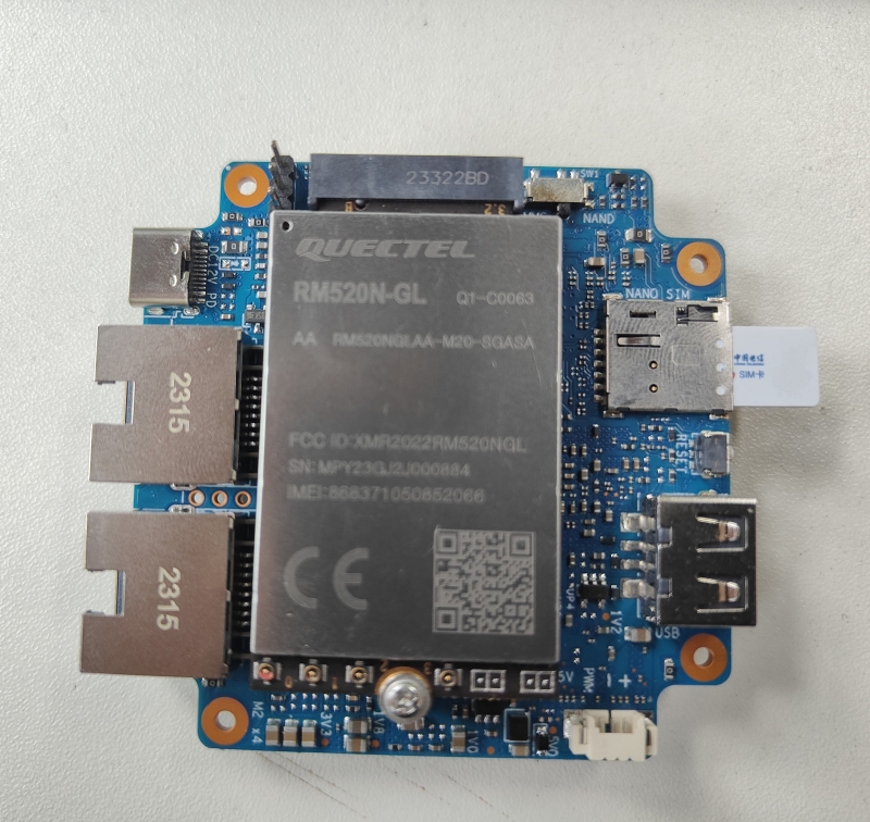

::1. Install 4G/5G Cellular Module into CN4 Slot(M.2 KEYB) | |||
::2. Inset the NANOSIM Card | |||
::3. Install antenna on the module | |||
::4. After powering on, it will automatically dial | |||
Note: The availability of 4G/5G depends on the local carrier frequency band. | Note: The availability of 4G/5G depends on the local carrier frequency band. | ||
[[File:BPI-R3_mini_cellular.jpg]] | |||

M.2 KEY B slot
currently, M.2 KEY B slot only support USB 4G/5G module, example: Quectel RM500U-CN or RM520N-GL
when you install one 4G/5G module, you may check it.
4G/5G Module
BPI-R3mini supports M.2 KEYB USB interface Cellular network module: 4G LTE EM05, 5G Quectel RM500U-CN/RG200U-CN and RM520N-GL/RM500Q-GL Series.
The released image(2023-11-15 or later) default driver is RM500U-CN and RM520N-GL, Install one of these two modules and you can use it directly.
If use EM05 or others,you will most likely need to modify the driver.
- 1. Install 4G/5G Cellular Module into CN4 Slot(M.2 KEYB)
- 2. Inset the NANOSIM Card
- 3. Install antenna on the module
- 4. After powering on, it will automatically dial
RM520N-GL
wwan0 Link encap:Ethernet HWaddr C2:CA:76:42:83:EC
NOARP MTU:1500 Metric:1
RX packets:0 errors:0 dropped:0 overruns:0 frame:0
TX packets:0 errors:0 dropped:0 overruns:0 carrier:0
collisions:0 txqueuelen:1000
RX bytes:0 (0.0 B) TX bytes:0 (0.0 B)
wwan0_1 Link encap:Ethernet HWaddr C2:CA:76:42:83:EC
root@OpenWrt:/#
root@OpenWrt:/# lsusb
Bus 001 Device 001: ID 1d6b:0002 Linux 5.4.188 xhci-hcd xHCI Host Controller
Bus 002 Device 002: ID 2c7c:0801 Quectel RM520N-GL
Bus 002 Device 001: ID 1d6b:0003 Linux 5.4.188 xhci-hcd xHCI Host Controller
root@OpenWrt:/#
root@OpenWrt:/# ping baidu .com
PING baidu.com (110.242.68.66) 56 data bvtes
64 bytes from 110.242.68.66: seq=0 ttl=50 time=38.540 ms
64 bytes from 110.242.68.66: seq=1 ttl=50 time=38.276 ms
64 bytes from 110.242.68.66: seq=2 ttl=50 time=38.355 ms
64 bytes from 110.242.68.66: seq=3 ttl=50 time=38.788 ms
^C
--- baidu.com ping statistics ---
4 packets transmitted, 4 received,0% packet loss
round-trip min/avg/max = 38.276/38.490/38.788 ms
root@OpenWrt:/#
RM500U-CN
usb0 Link encap:Ethernet HWaddr 46:F7:1B:36:AE:26
inet addr:10.101.26.65 Bcast:10.101.26.255 Mask:255.255.255.0
inet6 addr: 2409:895a:30a9:55e2:44f7:1bff:fe36:ae26/64 Scope:Global
inet6 addr: fe80::5c3b:9cff:fe76:7c46/64 Scope:Link
UP BROADCAST RUNNING MULTICAST MTU:1500 Metric:1
RX packets:191 errors:0 dropped:2 overruns:0 frame:0
TX packets:243 errors:0 dropped:0 overruns:0 carrier:0
RX bytes:71800 (70.1 KiB) TX bytes:35923 (35.0 KiB)
root@R3mini-Router:/#
root@R3mini-Router:/# lsusb
Bus 001 Device 001: ID 1d6b:0002 Linux 5.4.171 xhci-hcd xHCI Host Controller
Bus 002 Device 002: ID 2c7c:0900 RM500U-CN
Bus 002 Device 001: ID 1d6b:0003 Linux 5.4.171 xhci-hcd xHCI Host Controller
