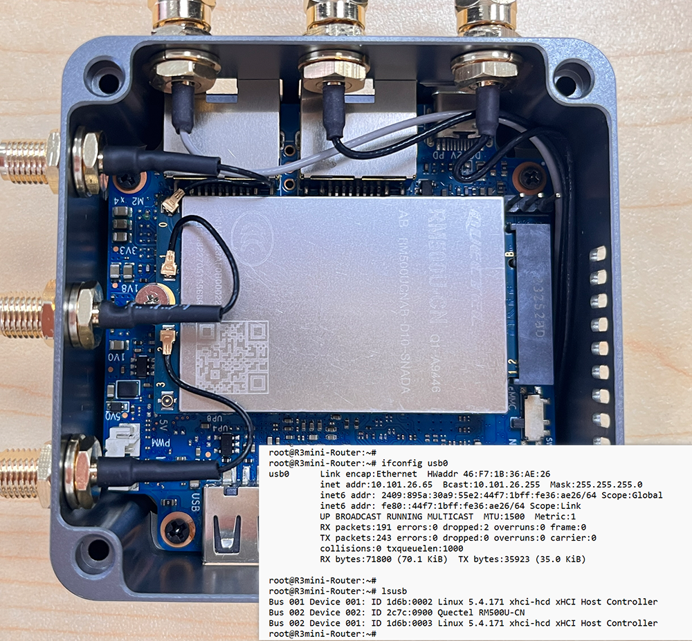

M.2 KEY B slot
currently, M.2 KEY B slot only support USB 4G/5G module, example: Quectel RM500U-CN or RM520N-GL
when you install one 4G/5G module, you may check it.
4G/5G Module
BPI-R3mini supports M.2 KEYB USB interface Cellular network module: 4G LTE EM05, 5G Quectel RM500U-CN/RG200U-CN and RM520N-GL/RM500Q-GL Series.
The released image(2023-11-15 or later) default driver is RM500U-CN and RM520N-GL, Install one of these two modules and you can use it directly.
If use EM05 or others,you will most likely need to modify the driver.
Note: The availability of 4G/5G depends on the local carrier frequency band.

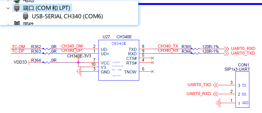

Serial cable
Because the UART0_TXD of the debug port is also a wifi strap pin, this pin needs to be pull-low when poweron,
some serial cable have strong pull-up, such as PL2303,if it is inserted before powering on, it will cause the wifi chip to be recognized incorrectly, and the wifi function will fail.
Other types including cp2102,ch340 and FDTI are all available, serial cable power domian must be 3.3v TTL standard.
You can buy the serial cable here: https://www.aliexpress.us/item/3256805457599756.html?
If your computer has a USB TypeC connector and supports PD12V/1.5A (20W) or above, you can also directly use the computer to power BPI-R3mini.
Moreover, since BPI-R3mini has built-in USB to serial port chip CH340E, you do not need to use additional serial cables.
NOTE:If your computer does not support USB PD, then the R3mini will most likely keep restarting.
Because the power consumption of R3mini is relatively large (all peripherals are plugged in and the power consumption is close to 20W when running)
