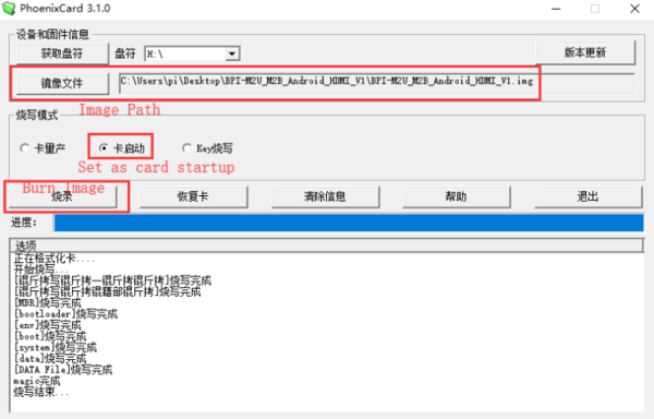

| − | ===Prepare | + | 1.You could download latest image from our forum. |
| − | + | 2.Put your TF card into a TF-USB adapter, and then plug adapter in your Windows PC usb interface. | |
| + | 3.Prepare your image, and download image burning tools PhoenixCard.exe. | ||
| + | 4.Use "PhoenixCard.exe" to burn android image to TF card. | ||
| + | [[Image:M3_Android_Burning.png | 600px]] | ||
| + | * Download PhoenixCard: https://pan.baidu.com/s/1-fjvPqtG_zewVzqnXf1AHw?pwd=eid9 | ||

1.You could download latest image from our forum. 2.Put your TF card into a TF-USB adapter, and then plug adapter in your Windows PC usb interface. 3.Prepare your image, and download image burning tools PhoenixCard.exe. 4.Use "PhoenixCard.exe" to burn android image to TF card.![]()
