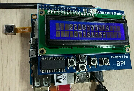

====RGB 1602 LCD==== | ====RGB 1602 LCD==== | ||

RGB 1602 LCD
- Execute "/usr/local/bin/bpi_test_lcd1602.sh"
