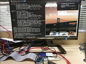

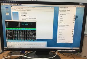

[[File:M2p_debian.jpg|thumb|Overview:BPI-M2+ Debian linux]] | [[File:M2p_debian.jpg|thumb|Overview:BPI-M2+ Debian linux]] | ||
