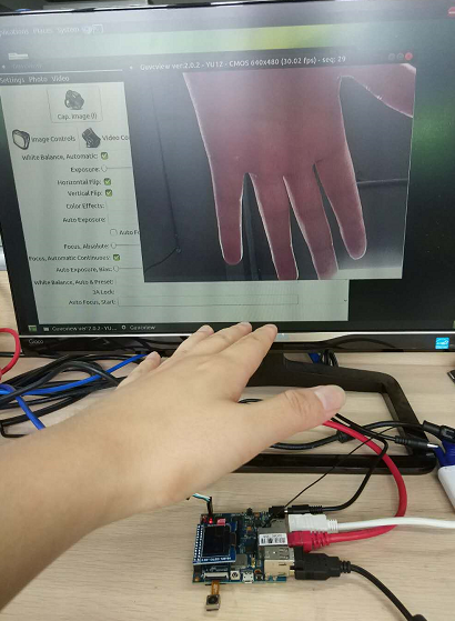

===Camara function=== | ===Camara function=== | ||
We use HDF5640 camara. | We use HDF5640 camara. | ||
[[Image:ov5640_camara.png]] | [[Image:ov5640_camara.png]] | ||
====Guvcview==== | ====Guvcview==== | ||
| Line 53: | Line 222: | ||
* Applications -> Sound & Video -> guvcview | * Applications -> Sound & Video -> guvcview | ||
[[Image:guvcview_ov5640.png]] | [[Image:guvcview_ov5640.png]] | ||
| + | ====Shell==== | ||
| + | * We also have built-in command in /usr/local/bin to test camara | ||
| + | * "./test_ov5640_image_mode.sh" to test picture taking function | ||
| + | * "./cameratest.sh" to test video recording function | ||

Camara function
Guvcview
- Use your UI interface to operate camara
- Applications -> Sound & Video -> guvcview
Shell
- We also have built-in command in /usr/local/bin to test camara
- "./test_ov5640_image_mode.sh" to test picture taking function
- "./cameratest.sh" to test video recording function

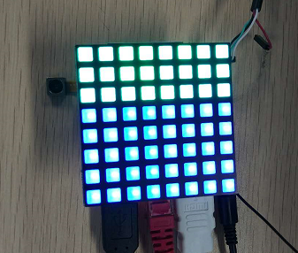

8x8 RGB LED Martix
- Firstly you need a GPIO Extend Board for 8x8 LED Martix
- Execute "/usr/local/bin/bpi_test_gpio40.sh"
