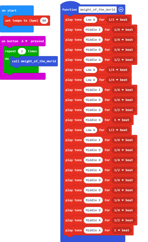

==Use the buzzer==
Learning Objectives: Write a piece of music with Makecode and play it on the BPI-QCar buzzer
The routine is shown in the figure below. Burn the program into Micro:Bit, connect Micro:Bit to BPI-QCar,press the a button once,and the buzzer on BPI-QCar will play the song twice in a cycle

学习目标:用MakeCode编程编写一段曲子并在Q-Car的蜂鸣器上播放
Press button a and wait until the calibration procedure is completed. The LED matrix will display the left arrow. At this time, make the front of Q-car face the line travel direction.
例程如下图,将程序烧录进Micro:Bit,将Micro:Bit与Q-Car连接,Q-Car上的蜂鸣器将循环两次播放曲子
Press button B and Q-car will start line patrol driving. During driving, if the ultrasonic ranging module detects an object with a distance of less than or equal to 10cm in front, Q-car will stop.
[[Image:Q-car_Music_Arrangement.png]]
