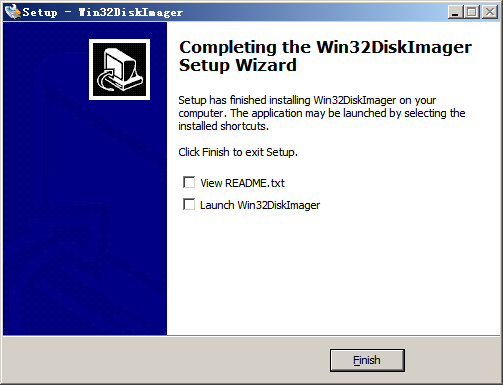

Install Win32DiskImager 安装Win32DiskImager
open win32diskimager-1.0.0-install, choose “I accept the agreement “,
“Next> “, then choose “Create a desktop shortcut”
“Next> “, after that install the software. Like the follow picture:
首先打开软件win32diskimager-1.0.0-install,选择I accept the agreement ,在选择Next>,然后勾选Create a desktop shortcut,在选择Next>,接下来选择Install开始安装,最后选择Finish,安装完成,如下图所示:
