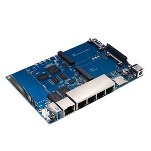

+ | [[File:BPI-R64_3.JPG|thumb|[[Banana Pi BPI-R64]] with BPI-7402 POE module]] | ||

PBI-7402 PoE Hardware
